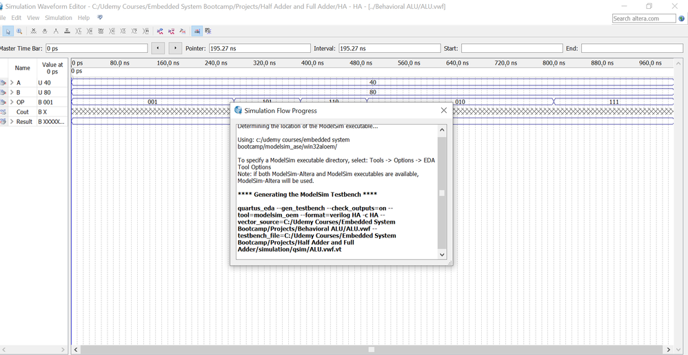

I get stuck with the following small pop up message every time i click "run functional simulation"

I'm always surprised that people are still using the Quartus simulator instead of Questa or even ModelSim, since it was phased out years ago. What version of Quartus is this?
That being said, right off the bat, I'd say you need to get rid of all those spaces in your paths. Modelsim for sure will not work correctly with spaces in any path names.

Do you able to solve the issue by removing the empty space in the path?
Is there any error message in the pop up window?
