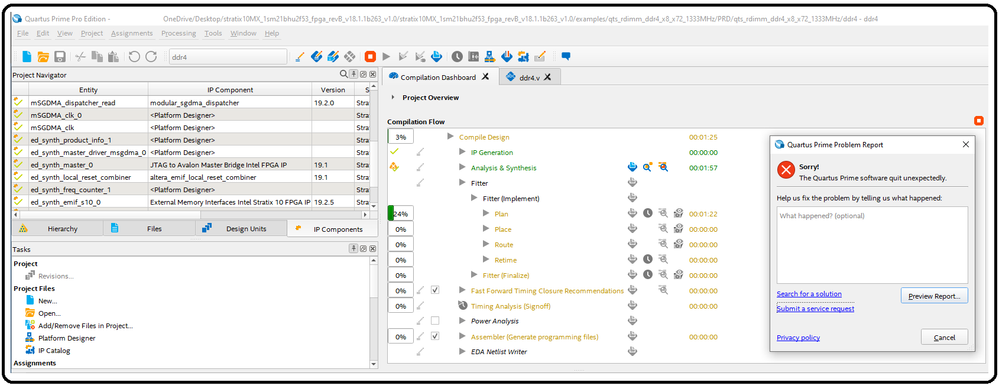

Quartus Prime Pro Edition: Compilation Failure.
I was trying to compile one of the provided example designs that came with Intel Stratix 10 MX FPGA Development Kit (8GB).
However, the compilation process failed unexpectedly using 30-day free-trial license.
May I ask why I encountered the following scenario please ??
Any help would be appreciated.
TH
  • sstrell's avatar
    sstrell
    That's a crash, not a compilation failure. Try deleting the qdb directory and compiling again.
