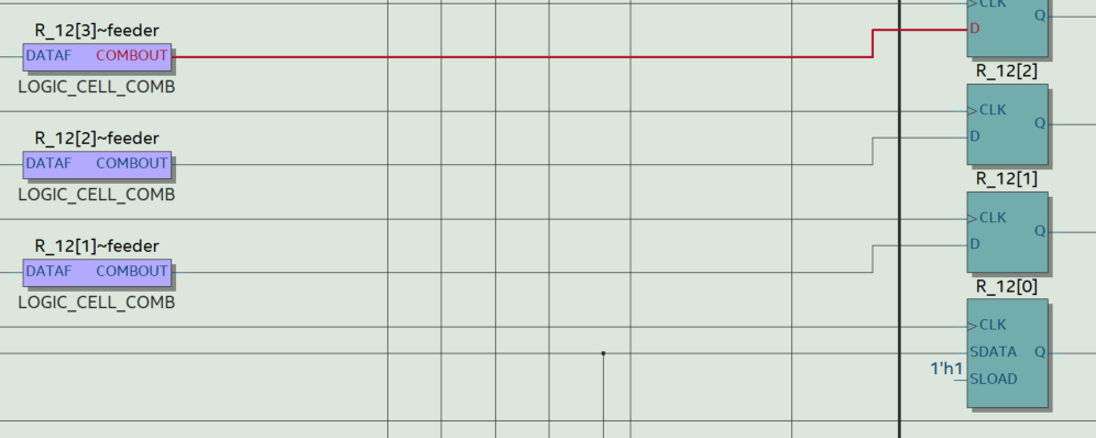

I'm using Quartus to program a Cyclone V FPGA and it instantiates redundant feeder logic I'd like to remove (pic). The verilog that it does this for is very simple; it's just a reg that's driven by a delay line (pair of inverter gates):
wire [8:0] DL_0;
reg [8:0] R_0;
DelayLine #(1) DLIN_0 (enable, DL_0[0]);
genvar k_0;
generate
for (k_0=1; k_0<9; k_0=k_0+1) begin : generate_rdels_0
DelayLine #(1) DLK_0 (
.in(DL_0[k_0-1]),
.out(DL_0[k_0])
end
endgenerate
genvar j_0;
generate
for (j_0=0; j_0<9; j_0=j_0+1) begin : generate_regs_0
always @(negedge DL_0[j_0]) begin
R_0[j_0] <= node[0];
end
end
endgenerate
Can anyone help me with this? I've played around with the settings for the compiler and fitter to no avail (turned off register duplication, etc.)

    Could you provide the design.qar for investigation? What is the software version?

    i am FPGA beginer, i also got this '~feeder', but i don't know what it stands for? I'm confused where this '~feeder' comes from and what does it mean?
    Did you get any ideal about it?
