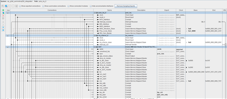

Hi, We refer to the following article and implement MSI-X interrupt in our FPGA. https://forums.intel.com/s/createarticlepage?articleid=a3g0P0000005ReB&action=view Our design is according to...
