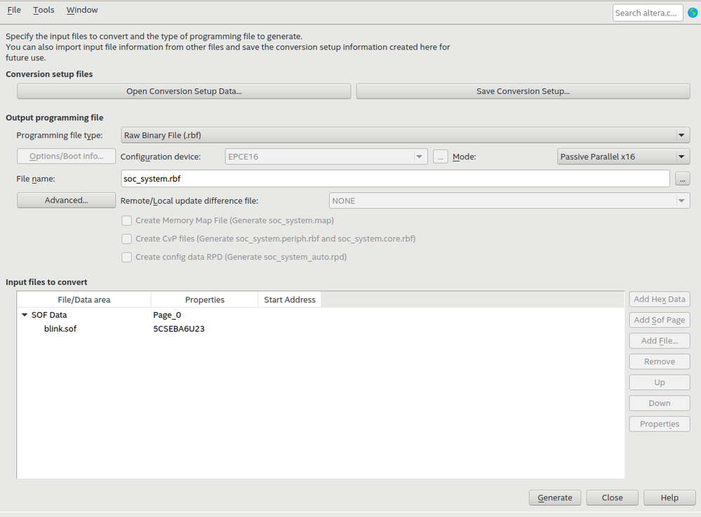

- Convert the sof to rbf using File > Convert Programming File. This will open a new window.
- Under 'Programming File Type', select 'Raw Binary (.rbf)'
- Under 'Mode', select 'Passive Parallel x16'.
- Name the output file `soc_system.rbf`.
- In the Input files section, click on SOF Data and click on 'Add File'. Select the sof file. In my case it was at `output_files/blink.sof`.
- Click Generate and close the window.
Here is a screenshot:

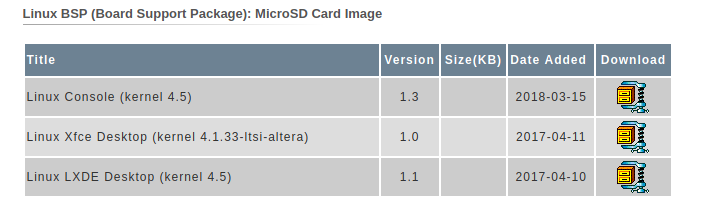

On the software side, to deploy this from the HPS, you need to use the console only version of Linux ("Linux Console (kernel 4.5)"). This can be downloaded from the Terasic website.
The reason you can't use the LXDE version is because it makes use of the HDMI output which is connected to the FPGA fabric and the hardware design should be able to work with it. It will still flash the rbf, but linux won't boot.
