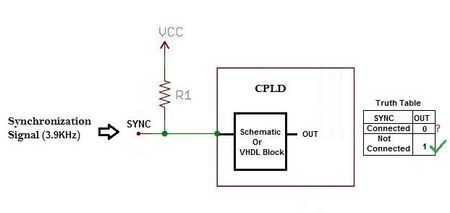

Thanks for your suggestions. I am not asking anyone to write code for me. See my subject again and just signal detection can’t be someone’s entire project.
BTW, I had posted this same question on another forum and got a suggestion to ‘implement detector of the rising edge for the sync signal. You could implement counter (startingelectronics dot org/software/VHDL-CPLD-course/tut19-up-down-counter/ ) which would increment every rising edge of SYNC and on every time pulse (say 1ms using m clock), you would check if the counter changed.’
I have implement the logic, below is the code. But it is working only first time connection of sensor. When I disconnect the SYNC signal the output doesn’t goes to low. Please advice the changes, I am beginner in VHDL and not an expert.
library IEEE; use IEEE.STD_LOGIC_1164.ALL; use IEEE.STD_LOGIC_UNSIGNED.ALL; entity sync_detector is Port ( SYNC : in STD_LOGIC; -- Input SYNC signal PULSE : in STD_LOGIC; -- Input 1.024ms pulse OUTPUT : out bit -- tells SYNC status ); end sync_detector; architecture Behavioral of sync_detector is signal S0_s : std_logic := '1'; signal counter_running : std_logic := '0'; signal count : STD_LOGIC_VECTOR (3 downto 0):= X"0"; begin S0_s <= not(SYNC); -- Process for 4-bit counter process(S0_s) begin if (S0_s'event and S0_s= '1') then count <= count + '1'; counter_running <= '1'; end if; end process; -- Process to check counter running after each 1.024ms process(PULSE) begin if (PULSE'event and PULSE = '1') then if counter_running = '1' then OUTPUT <= '1'; else OUTPUT <= '0'; end if; end if; end process; end Behavioral;- Vicky16 years ago
