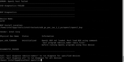

  4. I am able to run `aocl diagnose`, below is the output. The diagnostics is passing but PAC remains uninitialized

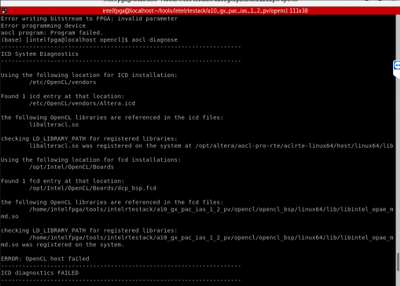

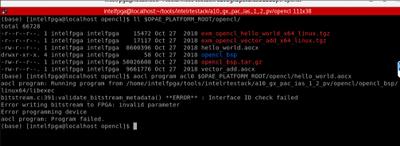

  5. Latter when I tried programming a bitstream file into the PAC, it shows this error

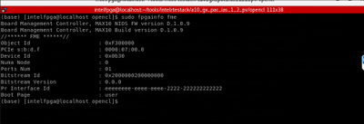

  6. I ran `sudo fpgainfo fme`, and the Pr Interface ID: eeeeeeee-eeee-eeee-2222-222222222222 seems weird. It's not expected per the setup manual, and the ID is definitely off. Not to mention my Bitstream version is 0.0.0 and MAX10 version is too low.
