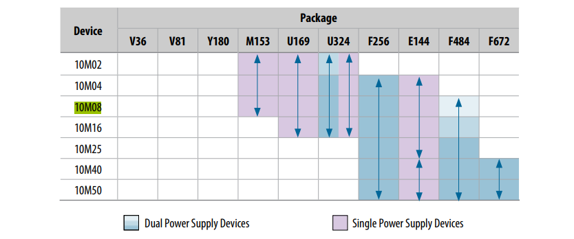

    Yes, as mentioned in the Intel® MAX® 10 General Purpose I/O User Guide, 1.8V LVDS only support in dual supply devices.
    For your device, 10M08SCU169, it is a single supply device indicates from the letter "SC". You can always refer the ordering information from the link below:
    https://www.intel.com/content/www/us/en/docs/programmable/683658/current/device-ordering-information.html

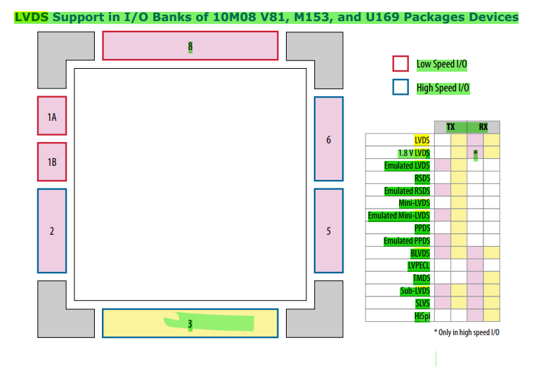

      Snapshot from Intel® MAX® 10 General Purpose I/O User Guide
