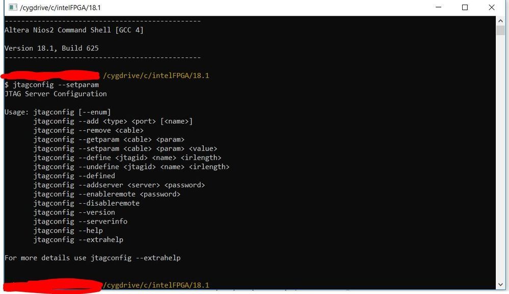

- ShafiqY_Intel
For mine, I just execute "jtagconfig --setparam " command to find out supported command.
May I know do you used USB-Blaster II cable or Onboard USB-Blaster II?
I dont think you can change frequency on the Onboard USB-Blaster II.
