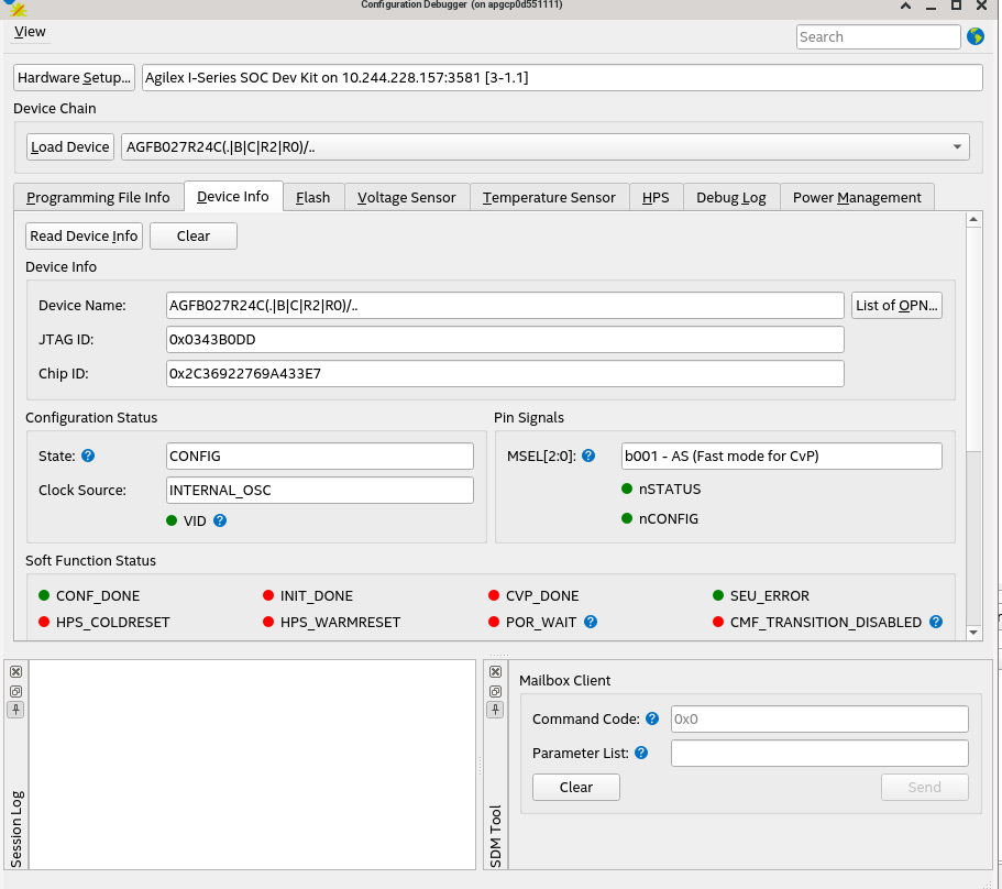

    Can you use Quartus configuration debugger to see if the device power up successfully? (attached config debugger status)

      Hi Farabi,
      Thanks for your reply. Find captured.
      We observed that if we keep the auto-adjust frequency at chain scanning, then we are not able to scan the device.
      Also, if we keep the hardware frequency low 16/6MHz then we are able to program Agilex5 as expected. But after programming, if we want to access the JTAG port from Python code, then it is not accessible every time and throws JTAG chain broken error.
