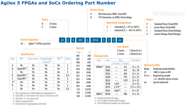

The Altera Agilex 5 product breif says the this FPGA has PCIe, but on the Dev kit this have not been installed.
The pins for this should be exposed right? Is it possible that I could attach a PCIe component myself and how would that be possible?

    DE25 Nano uses AE5EB device variant which has no transceivers. Thus no PCIe interface available.
    Frank
