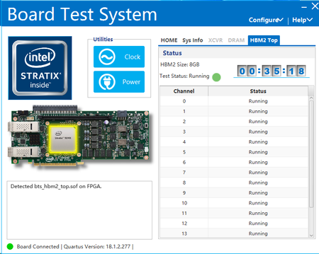

We find that the HBM on Intel Stratix 10 MX FPGA fails to calibrate successfully. After providing clock and releasing reset, the port local_cal_success is low and local_cal_fail is high. We also use ...

May I know which design that you used to perform the test?
May I see the calibration status signals as well?
How long does the BTS keep running?
