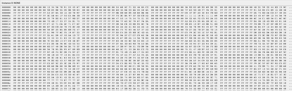

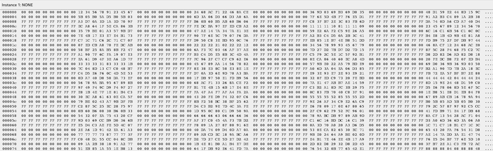

    Done trying ISMCE with width = 128 and depth = 4096. I'm not getting repeated memory bytes check screenshots below:
    ROM:
    RAM:
    Could you try with the attached ram_init_128_4096.hex and see whether got the similar results?
