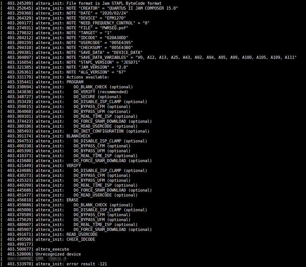

In Linux system, by the BMC , use altera-stapl driver to configure CPLD max2 with JBC file through JTAG interface, the result is given back as: Unrecognized device. How to solve this problem?
In addition, the altera-stapl driver comes from the Linux kernel and is downloaded from kernel.org , the asp-cpld is the JTAG code of the adaptive BMC.

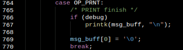

  • The driver code that prints the error message

  • The driver prints the following information

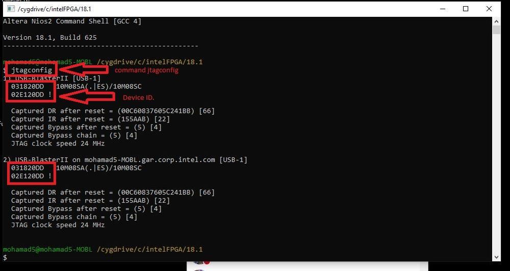

    Hi KLing4 ,
    Can you check your JTAG connection first whether it is working or not? (jtagconfig)
    open Command Prompt/Terminal ---> go to Quartus directory <Quartus installation directory>intelFPGA\18.1\quartus\bin64> ---> run jtagconfig
    Cheers

      The jtag connection is ok , I'm sure.
      • KLing4's avatar
        KLing4
        Sorry , I haven't .The answer by the custome . And they can use the Quartus-programmer to configure the device through the Jtag interface sucessfully.
