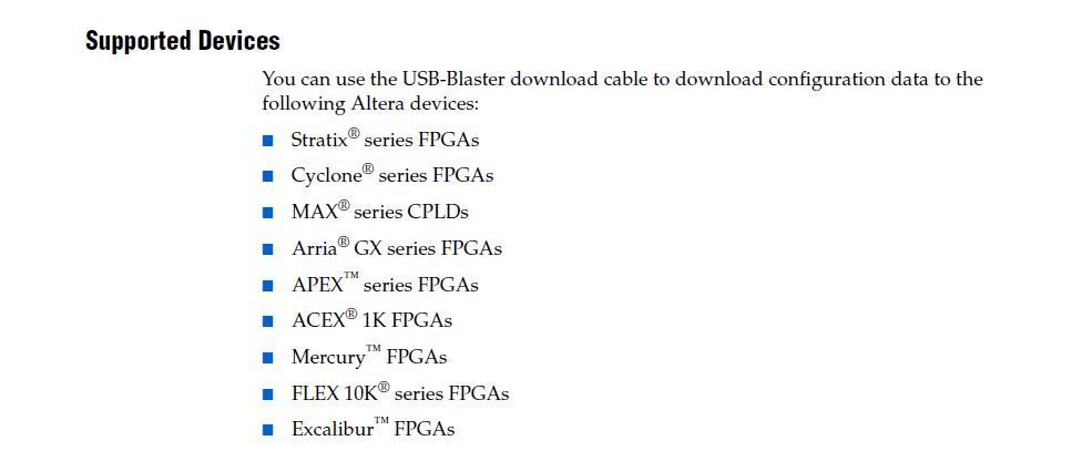

Thanks for your reply Anand.
We are looking for affordable price solution, P0302 Terasic Technologies USB BLASTER. In the userguide of P0302 it shows that the supported devices of P0302 includes only Max10 Series CPLDs. Please have a look on the attached image (showing P0302 supporting devices) . Kindly confirm that P0302 Terasic Technologies USB BLASTER support Max10 series FPGAs also. And also please let me know if there any issue is raised while using P0302 for programming Max10 series FPGAs.
- AnandRaj_S_Intel
You can use P0302 Terasic Technologies USB BLASTER for MAX 10 device.
No issues on usb blaster for more information issues you can check in KDB.
