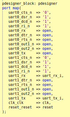

4 years agoHow to route HPS peripherals to FPGA
I have Arria10 SoC Dev Kit. I want to use it's UART modules in my FPGA logic but all 2 of them connected the HPS side. They connected HPS shared I/O pins. So I can be route them to FPGA. I used...

4 years agoHow can I do that? Can you help?
sstrell
4 years agoYou make connections in Platform Designer to IP you add to the system there or export the interface and connect to HDL code you write through port mapping. You should learn more about how to use Platform Designer to help understand what you need to do. You can start here:
