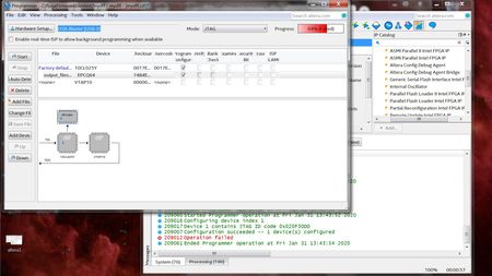

6 years agoHow to get *.jic to work on Cyclone 10 lp Dev board
After connecting a USB Blaster to the dev board's JTAG connector and setting dip(4) to off, I added the flash-loader ip to my simple dff design. I synthesized everything and created a *jic file to th...

- JBuch6 years ago
HI Anand,
As described, I did that. Does not work. You state change file, to what? I already have it set to *.jic file as pictured.
James
