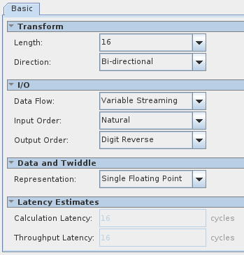

Thanks for your reply. I need to change FFT mode (forward and inverse FFT) in the runtime, so the FFT Intel FPGA IP is my best choice. Although I can modify the Variable Size FFT Intel FPGA IP to realize the same function, I want to make sure the problem mentioned above caused by the IP itself, instead of improper use of mine.

In the meantime, I understand that the Variable Size FFT Intel FPGA IP allows for a static configuration of Forward/Inverse mode during IP setup. Could you kindly elaborate on how you modified the IP to enable runtime switching between FFT modes?

The compute flow of inverse FFT contain forward FFT, so we can realize inverse FFT based on Variable Size FFT Intel FPGA IP (forward mode) by adding missing calculation steps.
