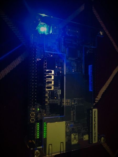

I was able to boot linux on the DE10-nano board using the given SD card with the board. However I tried to copy a file to the sd card. After doing so I was unable to boot linux on DE10-nano. Then...

You need to make sure the MSEL of the board is configured correctly. furthermore, I need a snapshot of the linux log messages to understand where is the boot failure.

7 years agoThank you for your reply. The MSEL is set to 010100. Could you please tell me how to get the log messages. I connected to the board with PuTTY. However I cannot type anything in PuTTY as before. The image shows that there is a red LED flashes when I type something in PuTTY.
