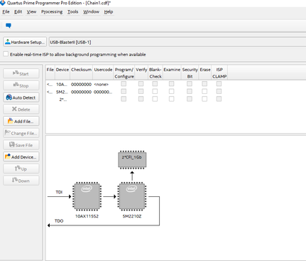

Dear Support,
I just got a second hand 10AX dev kit, it's power on, but nothing shows on the little display.
I connected the usb cable, the quatus programmer can detect the board. and after I select the 10AX115s2, it will show the linked device as in the attached picture, ( so I guess the board may be a good one). how to reset the board to default factory configuration if this board is a good one? please give me detail instruction or links to procedure. I am not very familiar to this board, and A10 FPGA.
Appreciate your help.
David Sun
