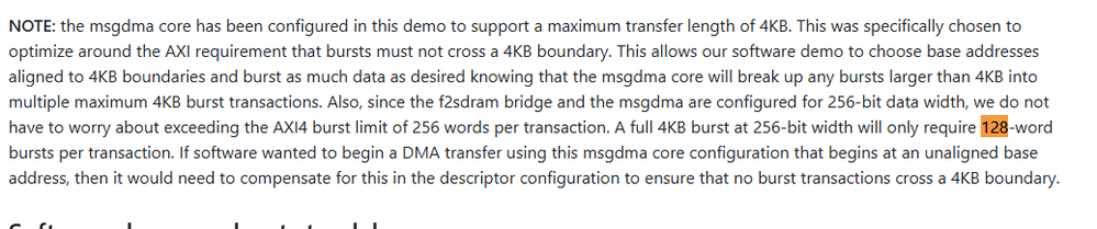

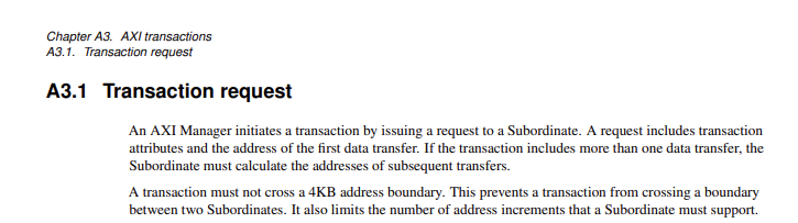

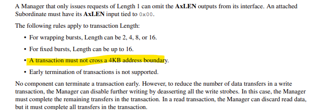

    As for this issue, I saw there is a requirement that any transaction cannot cross a 4KB boundary in the AXI protocol document (https://developer.arm.com/documentation/ihi0022/latest/) . Is your transaction adheres to this requirement?
    Perhaps you can refer to this demo example
    https://github.com/altera-fpga/agilex5-demo-hps2fpga-interfaces/blob/main/documentation/09_menu_p_hw_f2sdram_bridge.md

    Apologies for the delayed response as previously our embedded team did not monitor this forum category for embedded related question until we are notified by other teams .
