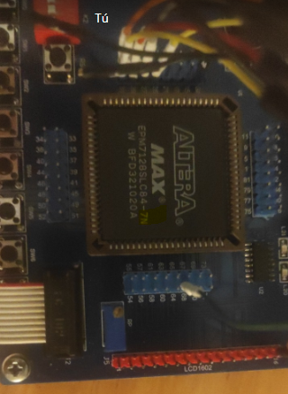

Hi AK6DN! thanks for your answer.
It was just typo, indeed, they all are EPM7128SLC. My best bet is those guys have screwed the jtag programing capability... When i power on those chips some light blink then stops, thus i guess there is already a program inside, maybe protected already from 3 party manufacturer project... Maybe they just have fetch those chips as they were on some board and announce on ebay....

- Armando19891 year ago
Hi Farabi
Chips had been returned and ive been refund. My best bet is as _AK6DN_, cplds cannibalized from scrap pcbs that have been previously jtag disabled by developer.
