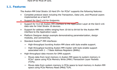

Avalon® memory mapped Intel® Stratix® 10 Hard IP+ for PCI Express* Solutions User Guide shows that Avalon-MM+ IP can support Gen8 x 16 for PCIe.
When I genetate a design with the IP, I find ...
