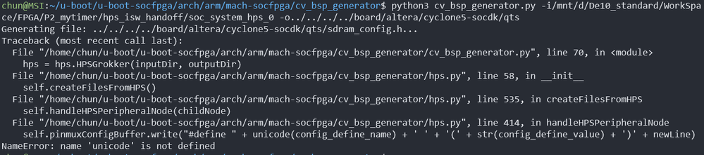

And this error occured:
Could you guys please help me fix that?
  • Hi,
    Yeah for that issue need to do this:
    To resolve the NameError: name 'unicode' is not defined, replace the occurrence of "unicode()" with "str()". This issue occurs because unicode() was renamed to str() in Python 3.
    Locate the unicode() in "cv_example.sdmmc/cv_soc_devkit_ghrd/software/bootloader/u-boot-socfpga/arch/arm/mach-socfpga/cv_bsp_generator/hps.py"
    Then replace the unicode with str, for e.g.:
    from
    ...( unicode("const u8 sys_mgr_init_table[] = {\n"))...
    to
    ...( str("const u8 sys_mgr_init_table[] = {\n"))...
    From my last experience these two seem to be the only issue I faced last time, it should be good after.

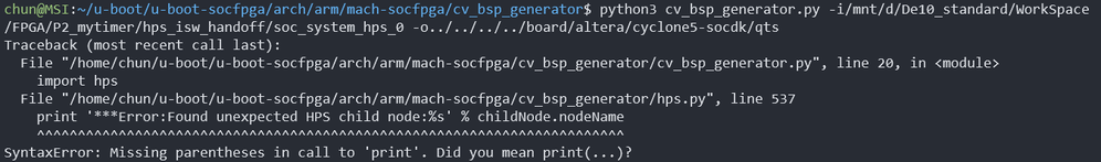

  • Hi,
    Can you find the file mentioned in the error, hps.py you can locate it as mentioned in the error, the directory.
    In the hps.py in the line "537" change it to this and re-try:
    print ("***Error:Found unexpected HPS child node:%s" % childNode.nodeName)
    • CAlex's avatar
      CAlex
      Good news is that fixed that syntax problem.
