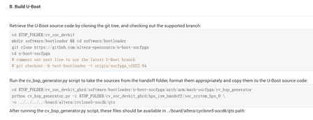

Yeah for that issue need to do this:
To resolve the NameError: name 'unicode' is not defined, replace the occurrence of "unicode()" with "str()". This issue occurs because unicode() was renamed to str() in Python 3.
Locate the unicode() in "cv_example.sdmmc/cv_soc_devkit_ghrd/software/bootloader/u-boot-socfpga/arch/arm/mach-socfpga/cv_bsp_generator/hps.py"
Then replace the unicode with str, for e.g.:
from
...( unicode("const u8 sys_mgr_init_table[] = {\n"))...
to
...( str("const u8 sys_mgr_init_table[] = {\n"))...
From my last experience these two seem to be the only issue I faced last time, it should be good after.
