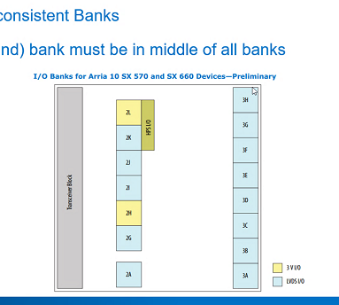

1 如何知道Arria10器件Banks 是否连续? 是根据手册里面的这个图去看? 2 在bank 里面摆放DDR, 剩余的IO是否可以当用户GPIO使用? 假如说一个bank里面DDR 占用了一个Lane ,剩下的Lane,用户可以使用?
是根据手册里面的这个图去看?
[Aida]: Yes, you are right. It is based on the picture shown in the manual. Extra info for I/O column 2 as below:
- Bank 2L and 2H is a 3V I/O bank which does not support OCT calibration hence it is not useable for EMIF
- Bank 2A is not adjacent to Bank 2G and 2H. Thus, if you require multiple EMIF's which may also required multiple I/O Banks, it cannot be place in Bank 2A.
