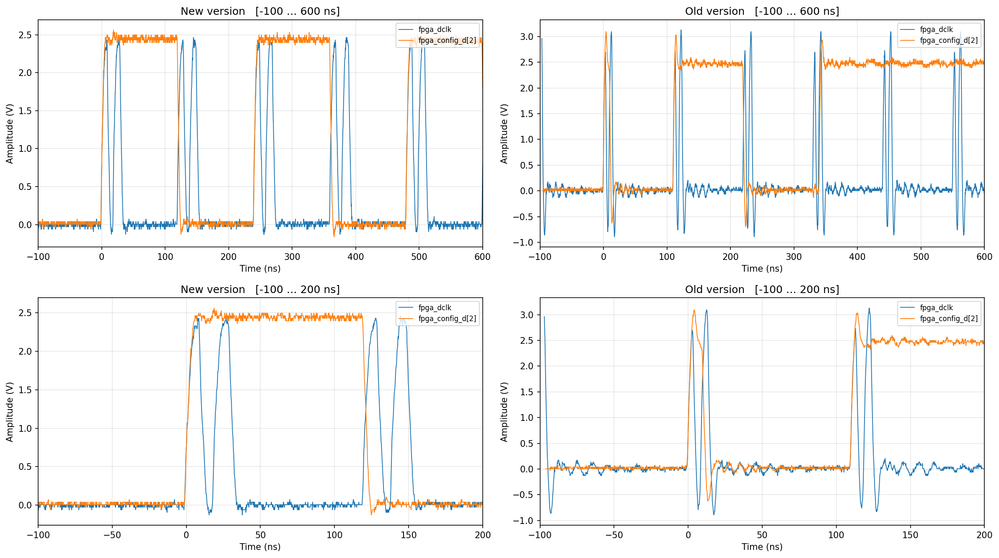

    GordWait an I kept investigating the problem and sharing our findings daily, until we got all our boards working 100% of the time on hundreds of reboots. While we ended up with slightly different solutions the root cause is the same, and I will share the core of what helped me for future reference.
    The root of the problem is presumably some signal integrity/timing issue across the fpga_config_d/fpga_dclk lines, which seems to be present only on newer boards/chips.
    The greatest improvement came from reducing the drive strength of these lines, by adding in the QSF:
    set_instance_assignment -name CURRENT_STRENGTH_NEW 7MA -to fpga_dclk
    set_instance_assignment -name CURRENT_STRENGTH_NEW 7MA -to fpga_config_d[*]
    While this solution helped on most of the affected boards it did not fix them all.
    To better improve the situation the fpga_dclk can be effectively reduced to 50 MHz, with the easiest way being changing the pfl_x8_inst's "Ratio between input clock and DCLK output" to 2. By doing this the fpga_config_d changes on the fpga_dclk's falling edge, thus improving the hold slack.
