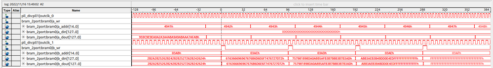

The SignalTap recording of the ports of the custom 2-port BRAM is in the next image:

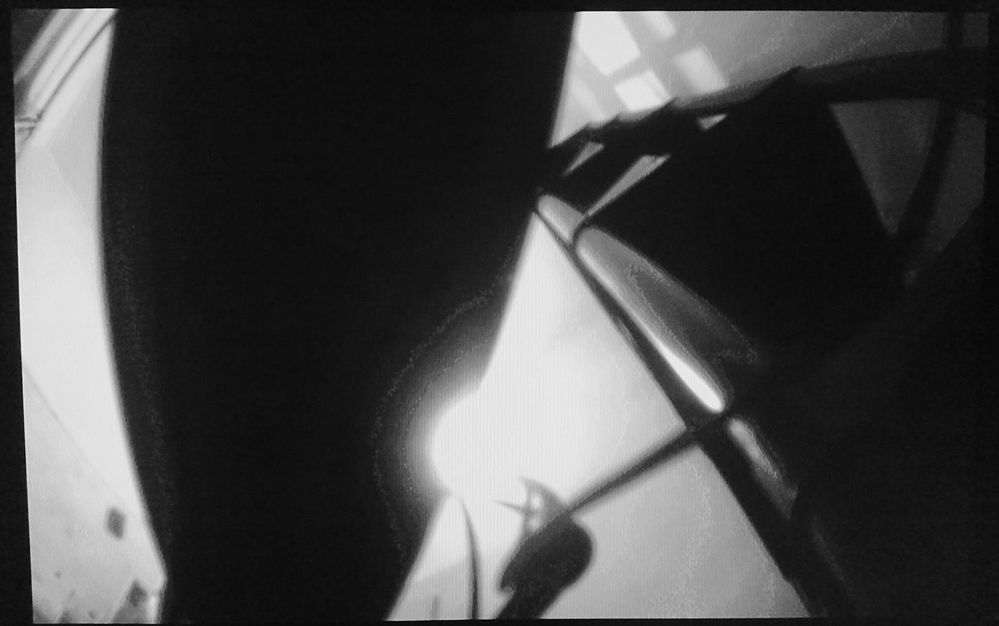

And the resulting image on the HDMI output looks as expected:

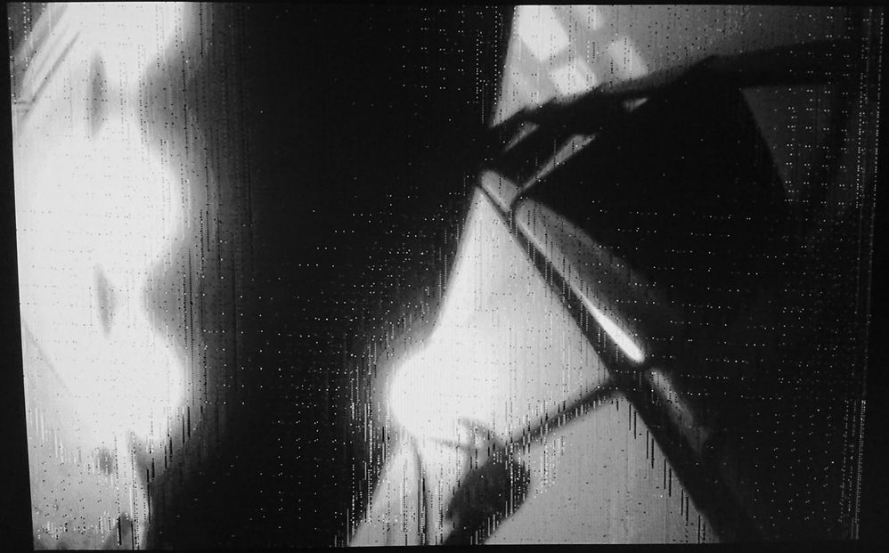

And it results in the following artifacts in the HDMI output:
I really don't understand why this is happening. I tried to feed the clock source with the derived 40MHz clock (I thought it could be a timing issue) but it behaves the same. The same problem happens with the Altera's 1-port RAM. When I comment out the system_soc component and remove the qip file from the project, it starts working correctly again..
