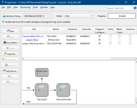

I unchecked the program/configure box with the .sof, thus the configuration was as follows the Figure.
In sequence, this error was presented to me: Error(209031): Device chain in Chain Description File does not match physical device chain -- expected 1 device(s) but found 2 device(s).
But, I found a similar case in this forum and I managed to solve the problem. The inclusion of a cdf file was enough to programmer the device.
JohnT_Altera
6 years agoHi,
I would recommend you to performed auto-detect 1st before adding the file into the programmer so the number of chain stay intact in your JTAG Chain.
