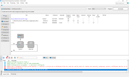

manishkumar
2 years agoHi,
with cycloneV only and disable all other devices:
1) through Jtag able to program .sof image, previously also able to program .sof image without disabling other devices
2) through jtag not able to program .jic image, getting silicon id error (screenshot attached)
kindly provide the solution to program .jic image through jtag
