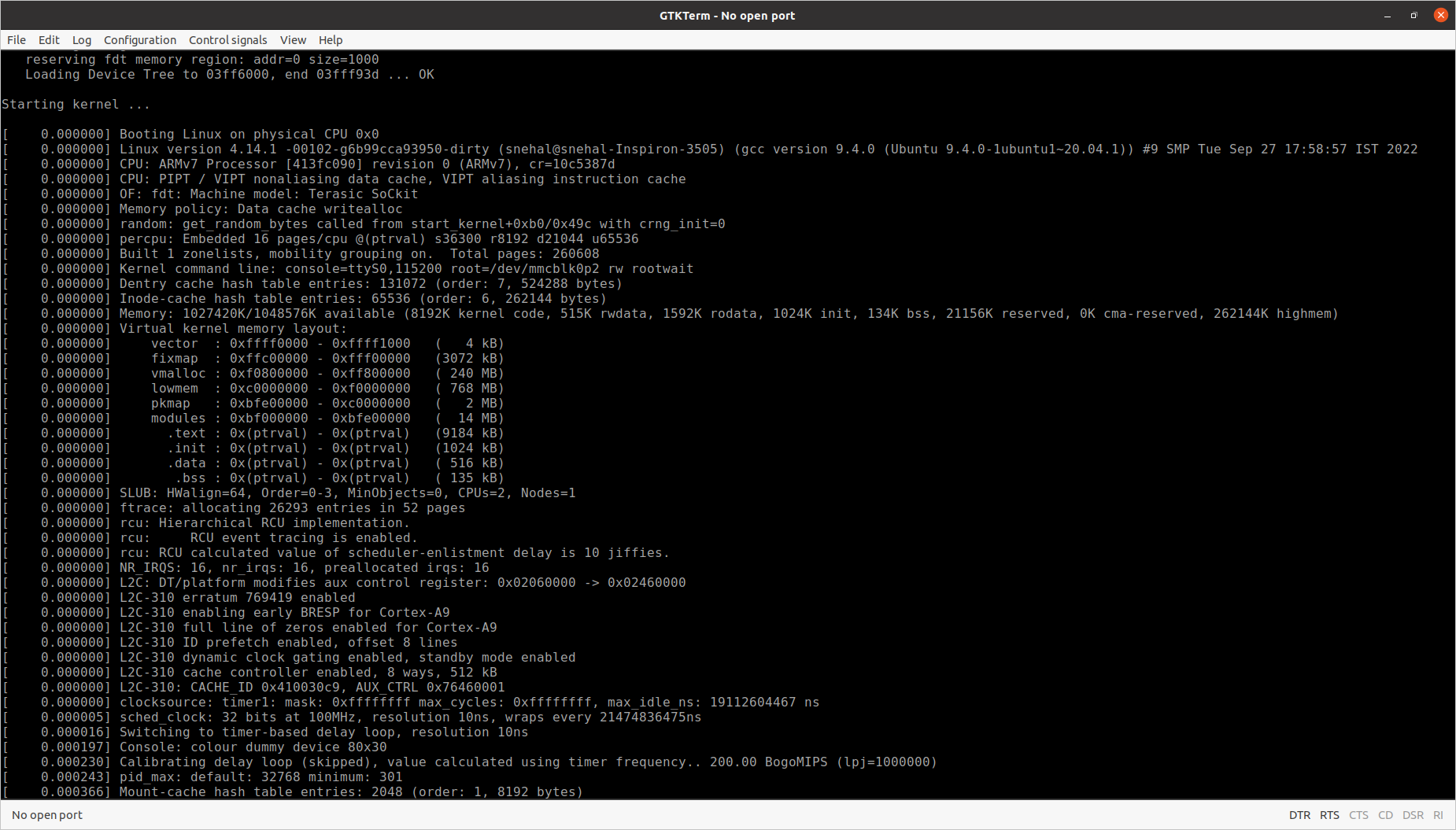

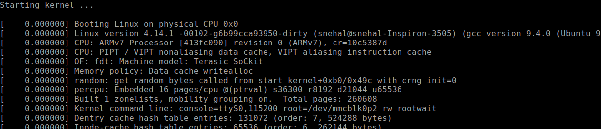

Customization of Boot image for DE1SOC cyclone 5 SOC board
I'm setting kernel version as 4.14.126 but it is getting set as 4.2.4.14.126
Using Buildroot for customizing image

I'm trying to customize the boot image to boot hps with linux version 4.14.1
I'm using buildroot to generate ZImage and rootfs with the steps in below link
https://www.rocketboards.org/foswiki/Documentation/EmbeddedLinuxBeginnerSGuide
by default settings the linux kernel version is 5.1 I want to set it to 4.14.1
can you please help me with the customization

I think you can locate the Makefile of your linux kernel and modify it accordingly before build:
https://github.com/altera-opensource/linux-socfpga/blob/socfpga-5.15.50-lts/Makefile
VERSION = 5
PATCHLEVEL = 15
SUBLEVEL = 50
Aik Eu

Hi snehal_p,
I think the below links will help to explain the problem:
https://www.linuxquestions.org/questions/linux-newbie-8/what-is-dirty-kernel-version-797711/
https://mirrors.edge.kernel.org/pub/software/scm/git/docs/user-manual.html#def_dirty
