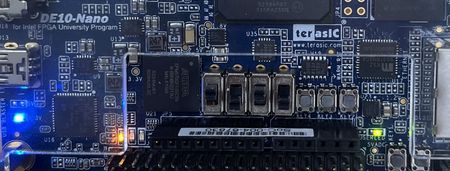

Hi, I'm a FPGA newbie with a DE10-nano board and have a problem with it. I use the USB blaster. When I supply power on my board, 3.3V Power LED, conf_done LED go HIGH, and USER LED blinks....

Do you have an SD card installed? If so, the HPS is probably booting and then reconfiguring the FPGA back to its default design.

Yes I already have inserted the SD card in my board. ;(
Sometimes the loaded data is gone and sometimes it remains.
What is the problem.. ~~
