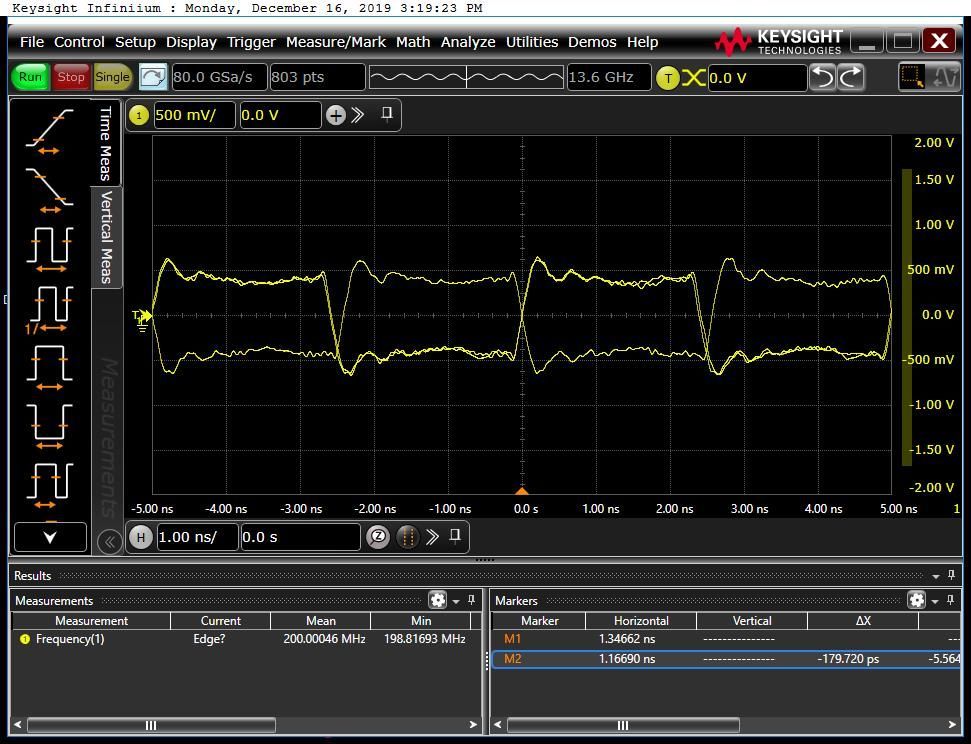

Hi everyone,
I want to know one thing that when I want to use altlvds tx to transimit 0->1->0 to make clock, I got the clock , its duty is not 50% no matter what the frequency, I don't know the matter, can anyone help me? The waveform of the clock is like below fig.

    Hi ,
    Can you check the losses in the board and try to see the simulation , and compare the board level simulation ( IBIS ) with actual result
