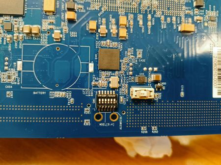

Recently bought a TR5 development board with a Stratix V GX FPGA on it. Then I download the FPGA development kit and try to run the BoardTestSystem.exe file but with no reaction. I has set the SW5.3 ...

As far we I know, TR5 hasn't BoardTestSystem.exe tool, where did you get this .exe? Maybe it's not for TR5.
BoardTestSystem.exe is specific for Intel's own FPGA boards. All Terasic FPGA boards haven't BoardTestSystem.exe, what they have is Controlpanel.exe or DashboardGUI.exe, Terasic hasn't controlpanel or dashboardgui.exe for TR5.
