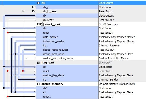

I try to compile simple project, nios onchip ram and jtag, but nios doaent start and timequest show slack inside nios. Can i run nios on 167MHz frequency?
