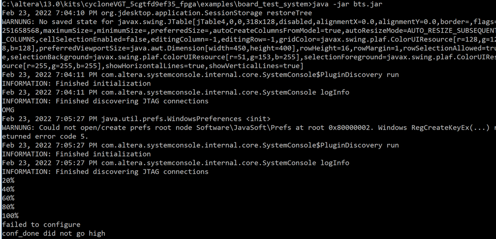

    • Zarquin's avatar
      Zarquin
      ... Little step further: BoardTestSystem.exe still no reaction but with java -jar bts.jar the application shows up.
      Next problem: When I try to configure the device, the message: failed to configure conf_done did not go high shows up.
      Complete console output:
      Any ideas how to solve this?
