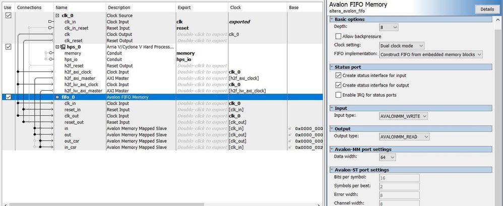

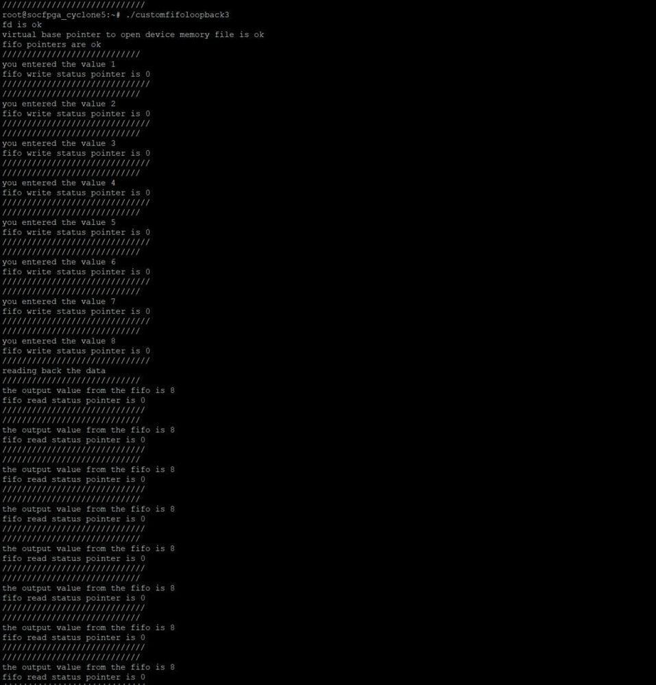

I simply connected my Avalon memory fifo to hps.But the read and write status pointers are not working, they are stuck always at 0. any ideas? c code is also attached he

printf("////////////////////////////\n");
printf("you entered the value %d\n",*FIFO_write_ptr);
printf("fifo write status pointer is %d\n",*FIFO_write_status_ptr);
printf("//////////////////////////////\n");
printf("reading back the data\n");
for(i=0;i<8;i++)
//reading data from the fifo
printf("the output value from the fifo is %d\n",*FIFO_read_ptr);
printf("fifo read status pointer is %d\n",*FIFO_read_status_ptr);
printf("/////////////////////////////\n");

1 Reply
- EBERLAZARE_I_Intel
According to our IP user guide, I am unsure if pointers value can be returned.
Have you look through the Avalon FIFO memory IP user guide?
https://www.intel.com/content/dam/www/programmable/us/en/pdfs/literature/ug/ug_embedded_ip.pdf#page=278
