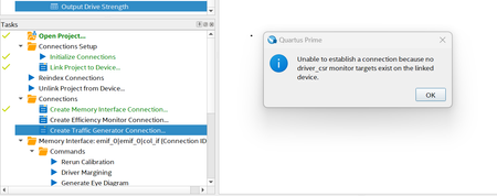

Hi Chris,
I have checked in internal data for this related issue.
It's seem that the "Create Traffic Generator Connection" only works with Traffic Generator 2.0.
Try to avoid clicking on that because it's might cause the Tools to hang.

Hi Adzim,
Since we are having a similar problem I am taking the liberty of continuing with a question.
Our custom board is using an Arria 10 SoC, and we are running Quartus Prime Pro 23.4.0
Question:
If I shouldn't click on "Create Traffic Generator Connection" then how am I supposed to actually run the TG?
