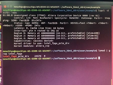

6 years agoAN881 reference design crashes on S10 MX (1SM21CHU) device
Hi, After the following discussion and some email communication, https://forums.intel.com/s/question/0D50P00004UIHagSAH/an881-reference-design-need-to-be-upgraded-for-device-1sm21ch, AN881 de...

- CHung6 years ago
The BHU board works.
Actually, the board is not at our hand,
the selling agent (i.e. Arrow) borrowed it from Intel Shanhai site, and returned the board after testing recently.
Arrow tell us the design works on BHU board.
I'll try the post-processing again,
but I remember that I've tried the script in previous experiments.
