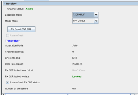

1 year agoAgilex7 CDR not locked to data
When using the F-Tile PMA/FEC Direct PHY Intel FPGA IP for PRBS testing, I am consistently unable to perform PRBS testing in external loopback mode due to the CDR not locked to data. Even when using ...

Upon reviewing the Toolkit screenshots, it appears that the CDR successfully achieves lock-to-data mode when using internal serial and parallel loopback configurations. However, when external loopback is used, the CDR fails to lock to data.
This behavior could be attributed to potential signal integrity issues in the external connection, incorrect pinout, or improper external wiring. Would you mind helping to further investigate these aspects?
