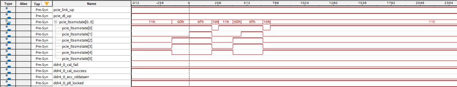

2. In signal tap I see LTSSM state is L0 with occasionally going through a recovery sequence.
I suspect a signal integrity issue and would like to check the Eye Diagram.
      >> Can I know exactly what stage the Ltssm is looping at ? Can you please provide me the printscreen of the signaltap ?
      >> or the hexa number of the ltssm will do.

        The link_up and dl_up are high and stable in signaltap. LTSSM is looping thru stages in the stp file attached once every few seconds (L0 most of the time).
        Knowing that, I tried to see the eye diagram for more info.
        This is my FW design on an intel devkit.
