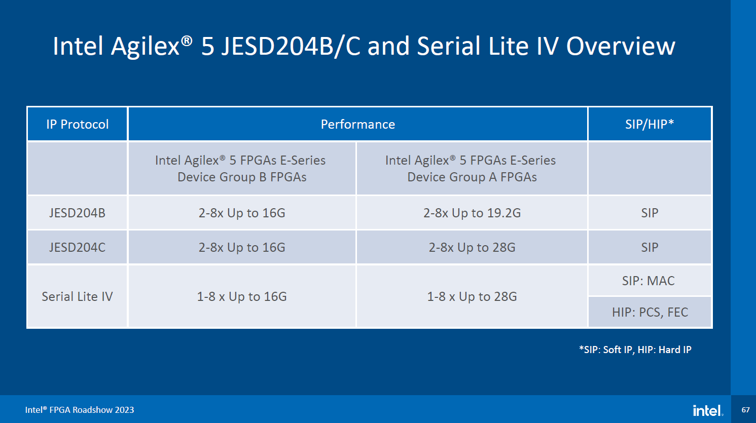

I want to use the JESD204B interface for the converters. The only IP core I can use in the project is the GTS JESD204C Intel FPGA IP. Theoretically, the JESD204C interface is backward compatible with JESD204B.
However, in the documentation, I found the information that:
"The GTS JESD204C Intel® FPGA IP is a high-speed point-to-point serial interface intellectual property (IP). The GTS JESD204C Intel® FPGA IP is the latest IP from Intel that supports the GTS JESD204C protocol. This IP is not backward compatible and does not support JESD204B protocol."
On the other hand, all announcements for this device assumed backward compatibility with JESD204B.
My question is whether future Quartus updates will include the JESD204B IP core or if this A5ED065BB32AE6SR0 device will only support JESD204C?
As of now no information for future versions on backward compatibility for jesd204b. (2.3. GTS JESD204C Intel® FPGA IP Features)
You can check jesd204b compatibility here: 2.2. Device Family Support (intel.com)
Agilex 5 not supported.
