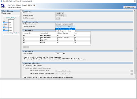

damonzhuNew Contributor2 years ago10M04SCU169C8G Altera On-Chip Flash IP core The FPGA model I use is 10M04SCU169C8G. Why is there no "Dual compressed images" option in the "Configuration mode" parameter of the Altera On-Chip Flash IP core? Show More
FvMSuper Contributor2 years agoHi,simple reason, compact type (10MxxxSC) doesn't support dual image. Review feature table in device overview
damonzhuNew Contributor to FvM2 years agoHi FvM, So, doesn't the "10M04SCU169C8G" have the ability to upgrade remotely? Thanks for the answer.
