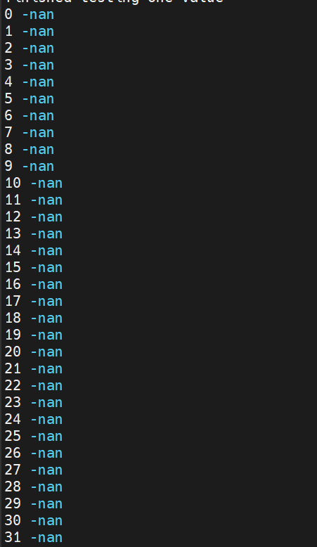

Weird behavior of dpc++ code after running it on FPGA device
I am using DPC++ to accelerate knn algorithm on FPGA device. The following code is the code I wrote for the euclidean distance. The problem is that the fpga_emulation works very well with no problems while running it on fpga hardware (Intel Arria 10 OneAPI) gives -nan for all values in the resulting buffer, which means something got wrong in the parallel_for lioop. But I can't find anything wrong about it and the emulation worked.
I am using Intel Devcloud platform.

results with fpga_emulation: ./knn.fpga_emu
results for fpga hardware: ./knn.fpga

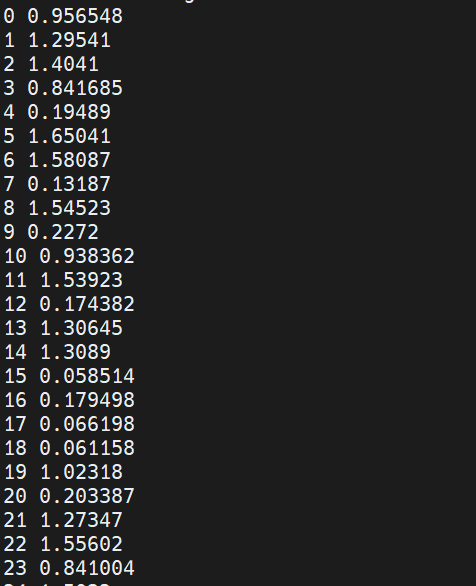

  • Hello Aik Eu,
    Thank you for your reply, I removed the no_init from the accessor and is now working correctly as expected.
    this line:
    accessor dif(res_buf, h, write_only, no_init);
    became this:
    accessor dif(res_buf, h, write_only);
    Thank you!

  • amaltaha's avatar
    amaltaha
    Hello Aik Eu,
    this line:
    became this:
    Thank you!
