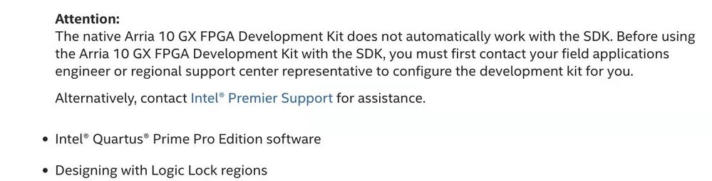

bear005
4 years agothanks, after I read the link you provided, I see what is in the picture. Does this mean that I plugged the FPGA directly into the server, and the problem that the OpenCL platform cannot be detected is that I didn't find a technician to configure the environment?
HRZ
4 years agoWhat is the exact model of the board you are using? If you are using a supported board which comes with an OpenCL BSP, you should be able to set it up yourself by following the documentation.
