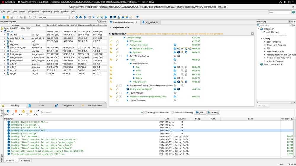

The compilation for the project takes 8 to 12 hours just for the IP Generation step and doesn't go any further, I have a system with 64Gb of RAM and an Intel i7 10th Gen. I have tried multiple different methods and commands but its still coming the same. It doesn't even show the exact issue which is causing the error. Also when i open the project in Quartus, in the Files Hierarchy tab only the top module is present, the other files aren't being shown.

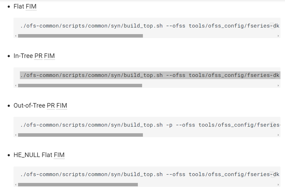

I notice that you mentioned you're running the command "I used this exact command - ./ofs-common/scripts/common/syn/build_top.sh -p n6000 work_n6000" which is quite different from what I see in the user guide
Could you try one of the commands (eg. Flat Fim):
./ofs-common/scripts/common/syn/build_top.sh --ofss tools/ofss_config/fseries-dk.ofss,tools/ofss_config/hssi/hssi_8x25_ftile.ofss fseries-dk:flat work_fseries-dk_flat
and see any errors with it, do remember to setup the project and environment variables.

Thank you for the above suggestion, I thought that "./ofs-common/scripts/common/syn/build_top.sh --ofss tools/ofss_config/fseries-dk.ofss,tools/ofss_config/hssi/hssi_8x25_ftile.ofss fseries-dk:flat work_fseries-dk_flat" command is only for the fseries board. Now that I changed my command to "./ofs-common/scripts/common/syn/build_top.sh --ofss tools/ofss_config/n6000.ofss n6000:flat work_n6000_flat" it runs perfectly.
