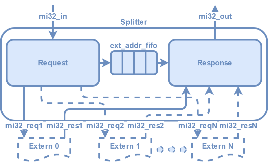

Generic functionality of component splitter, which can be seen in the attached picture.
Basic functionality of the request part:
- Read mi32_in input and forwards it (based on address) to the right output.
- If a request is READ, the request part writes address into ext_addr_fifo and starts response part.
If a request is READ and into another external block then before (i.e. first there was READ request into external 1, then into external 2), request part is stopped and waits for completion of all responses.
Basic functionality of the response part:
- Waits, until it started from the request part.
- Reads ext_addr_fifo and reads from extern block based on the address and writes to output.
