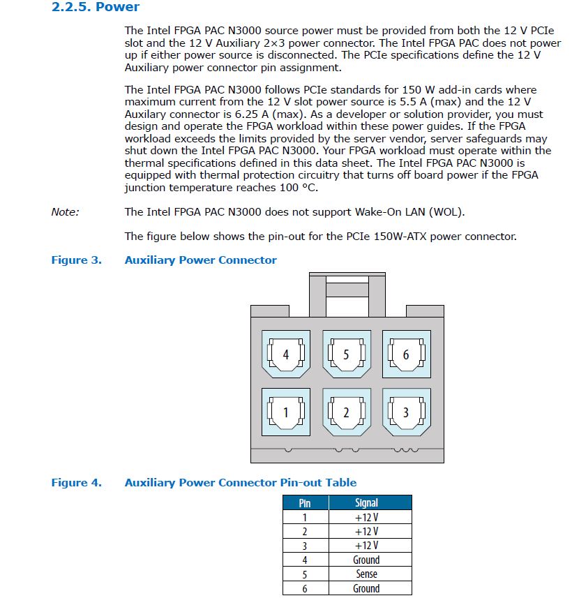

As per data sheet two H38461-001 cables need to connect on 12V motherboard port.
On FPGA card there is only single 6 pin port available to power up card.
Now we require to converge two 6 pin cable to one 6 pin to connect on FPGA card.
Can you please help with cable part number.
I am unable to get converger cable part number from cable vendor.
Just to double check, you could have referred data sheet snapshot of power requirement. Power should be given from both 12V port on motherboard correct?
