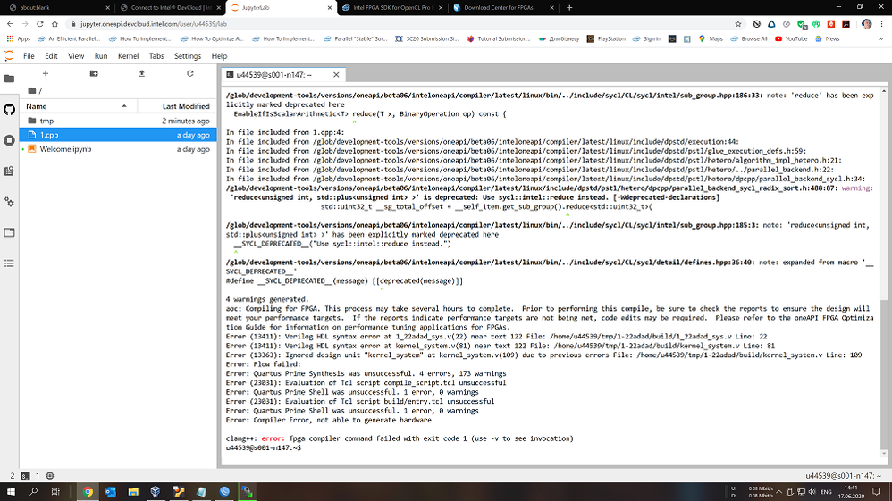

For a few last days long, I'm no longer able to compile and run my code in Intel DevCloud for oneAPI projects.
The attempts to compile and run my code typically end up with the following error message:
I would kindly appreciate for any assistance. Please help me to solve this problem. My DevCloud account id is u39016.

I'm sorry to inform you that this didn't work. First I've tried to compile of the samples for Intel PAC board and it finished compilation successfully, *BUT* when I tried to compile my project for Intel PAC hardware, the compilation ended up with the same error:
Error (170143): Final fitting attempt was unsuccessful
Error: An error occurred during routing
Error: Quartus Prime Fitter was unsuccessful. 2 errors, 675 warnings
Error (23031): Evaluation of Tcl script compile_script.tcl unsuccessful
Error: Quartus Prime Shell was unsuccessful. 1 error, 0 warnings
Error (23031): Evaluation of Tcl script build/entry.tcl unsuccessful
Error: Compiler Error, not able to generate hardwareclang++: error: fpga compiler command failed with exit code 1 (use -v to see invocation)
Makefile:19: recipe for target 'fpga' failed
make: *** [fpga] Error 1Looking forward to your reply and the following critical issue resolution.
