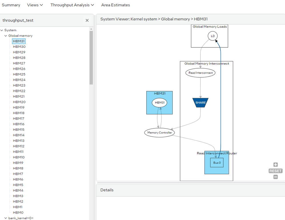

In full acceleration flow, (if target supports HBM) each HBM bank cab be accessed by specifying buffer_location when allocating memories.
You should be able to see HBM bank being used in your optimization report -> System Viewer:
-Kevin
